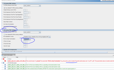

I am using stratix 10 SoC dev kit with Transceivers with 10Gbps speed.
There, I want to use External termination for the transceiver receiver pins. As per the L tile user guide, we can set r...

Quick update.
Quartus tool is ignoring the "set_instance_assignment " constraints in the QSF file.
"Warning(332145): Command "set_instance_assignment" found in SDC file is not a proper SDC command and is being ignored "

5 years agoHi ,
Can you please try on pin planner

Thanks for the suggestion. I missed this option. Will try & update.
