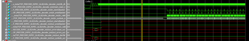

RSFEC decoder is not generating output
we are generating RSFEC decoder IP we are providing required signal as input but we are not able to see output in modelsim
This is suggested to use the example design to run the simulation. You can generate the example design from the IP GUI. From the generated example design, there is a simulation_scripts folder. You can refer to the script over there to run the simulation.
\rs_ii_0_example_design\simulation_scripts

Thank you @SengKok_L_Intel issue solved
