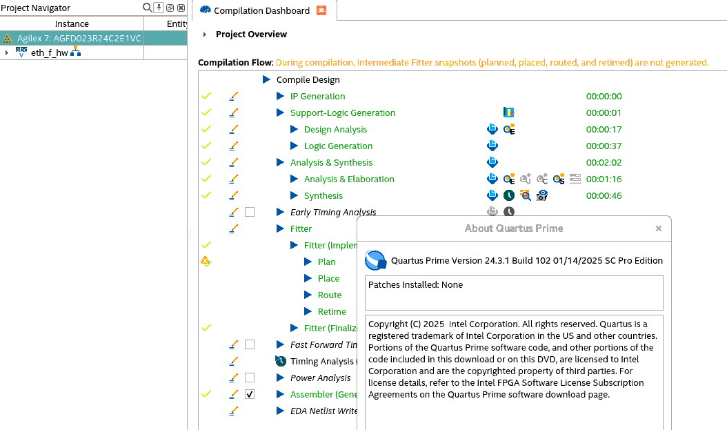

14 days agoUsing Q24.3.1 Pro to generate a FGT 400Gx8 example design and do migration to your target Dev Kit. The project can pass compilation.
I suggest you create the example design based on the current Quartus version you're using, rather than upgrading a project created by another version.
