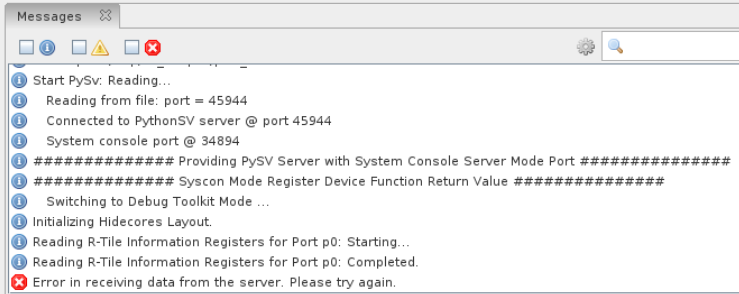

This is an issue sharing for Agilex R-tile PCIe:
The Rtile PCIe Debug Toolkit fails to launch in Quartus v22.4 with below message:
"Error in receiving data from the server? Please try again."
The steps to run the PCIe Debug Toolkit are documented here:
https://www.intel.com/content/www/us/en/docs/programmable/683501/22-4-8-0-0/launching-the-r-tile-debug-toolkit.html
Once the Debug Toolkit is initialized and loaded, you will see the following message in the Messages window:
To work around this problem, download and install patch 0.14 for the Intel® Quartus® Prime Pro Edition Software version 22.4.
https://www.intel.com/content/www/us/en/support/programmable/articles/000094124.html
This issue has been fixed in v23.1 and onwards.
