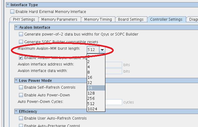

    avl_size is generated according to the maximum AVMM burst length, the default length is 4, this is why you will find the signal is only 3bits. You can enlarge burst length is you want to improve efficiency of controller.

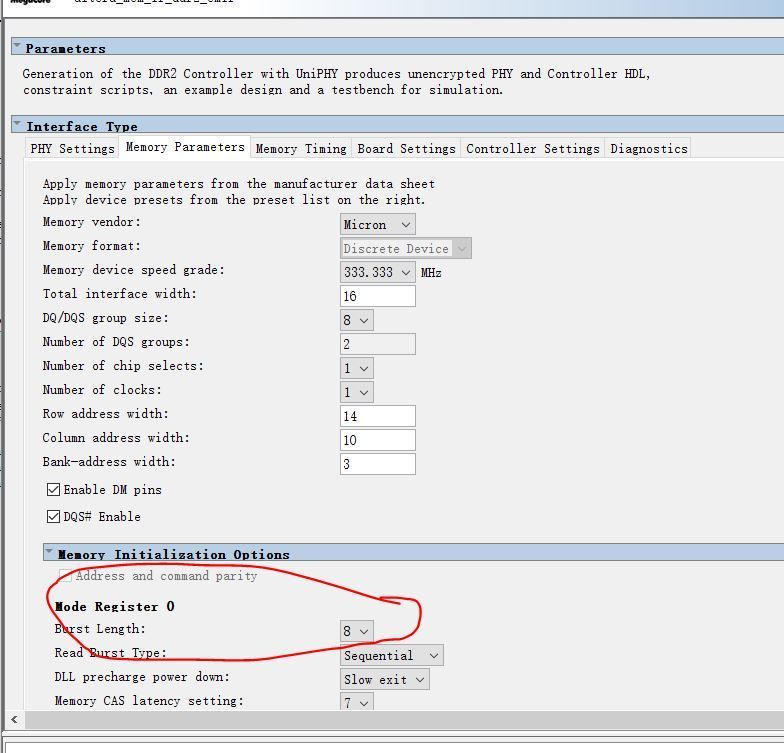

      Should that setting impact the burst length of below?
      • ybin's avatar
        ybin
        The setting you mentioned doesn't impact avl_size, but it can impact efficiency, the default value is 8, no need to modify it. You can just modify maximum AVMM burst length value.
