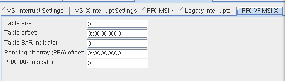

    For MSI-X, you will need to configure the parameters in the IP GUI as below:
    IP Settings -> Interrupt capabilities -> PF0 (VF) MSI-X
    And this parameters is map to the Figure 46 “MSI-X Capability Registers” as describe in the UG- https://www.intel.com/content/dam/www/programmable/us/en/pdfs/literature/ug/ug_a10_pcie_sriov.pdf#page=82
    So, from the host (driver), you will need read these MSI-X capabilities register to check the table and PBA offset.

    If you set the VF msi-x table size to 2. Does this mean you have two distinct interrupts that can be generated? -> Yes
    Does this also mean that every other VF also has this msi-x table of size 2 as well? -> Yes
    You can see the table is actually assigned to a BAR that you set in the GUI. And you have to define the table by yourself. The table that mentions here is in Figure 32. Format of MSI-X Table.
    I also need more clarification on where the msi-x table and pba table actually reside. For example, if I set BIR to be 0 for VFs. Where does this table actually reside? Is it in the user-application on-chip memory of the VF bar0 at address offset 0? Then to generate an interrupt for VF 1 go to that memory location read the addresses and set the request and set the PBA to the appropriate value?
    è If I understand your questions correctly, then the answer is yes for all. It is depending on what component you connect the MSI-X BAR. Most of the user connects it to an on-chip memory that contains the MSI-X table. For details, you may see Figure 31. MSI-X Interrupt Components. Items 1-5.
