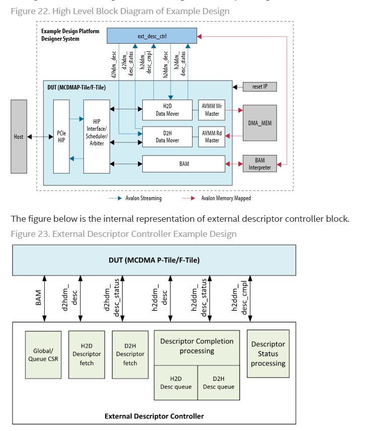

Here is the block diagram for example design from the webpage
I find that this example design is the closet to PoC design I want to create. I need more help in understanding the External Descriptor Controller Example design so that I can figure out where and what can I change to meet my design needs. I have following questions to begin
  1. While following steps to generate design example using quartus/platform designer, I see that BAR 0 is chosen to be 4MB. While analyzing design In platform designer I see that DUT (blue box in figure 22 above)dut.po_bam_master port is connected to BAM_interpreter (grey box in figure 22 above)BAM_INTERPRETER_M0.AVMM_BAM_SLAVE port and address mapping is 0x0 to 0FFF_FFFF (256MB) which is greater than 4MB BAR0.
    1. I want to understand how current design is using 256MB of space. can you help?
      1. What offset is used for what purpose ?
      2. Are BAR0 (4MB) accesses are mapped to "BAR interpreter" (grey box) in above figure 22? If yes, what 4MB range between 256MB address range is mapped to BAR0?
      3. How BAR0 4MB space is used? What offset is used for what purpose ?
  1. While analyzing design In platform designer I see that DUT (blue box in figure 22 above)dut.po_h2ddm_master port is connected to DMA_MEM (grey box in figure 22 above)DMA_MEM_M0.AVMM_H2DDM_SLAVE port and address mapping is 0x1_0000 to 1_7FFF (32KB) . Similarly, dut.po_d2hdm_master port is connected to DMA_MEM (grey box in figure 22 above)DMA_MEM_M0.AVMM_D2HDM_SLAVE port and address mapping is 0x1_0000 to 1_7FFF (32KB) .
    1. What is the reason here to have starting offset as 0x1_0000 for both AVMM connections? I mean the address ranges could also be 0x0 - 0x7FFF; but so what is the reason behind choosing address range 0x1_0000 to 1_7FFF?
    2. In platform designed when I click on DMA_MEM_M0 it shows an IP which I am not quite familiar with. But it feels like that it is Dual ported RAM. My question is can I replace DMA_MEM_M0 with Dual ported RAM IP (2 AVMM slave ports and Ip Configured for 32KB memory) without breaking example design functionality ?

  • Hi,
    I'd like to confirm that you're targeting a MCDMA Data Mover+External Descriptor Controller design using Q25.1 Pro, right?
    Rong
  • UserID4331231's avatar
    UserID4331231
    Hi RongYuan
    I confirm that I am using MCDMA Data Mover+External Descriptor Controller design using Q25.1 Pro.
    and I plan on using PCIe EP on R-tile. The FPGA Device I have is Agilex 7 - AGIB027R29A1E1V.
  • Hi,
    After reviewing, these questions require more detailed investigation. Please kindly contact your local FAE/DFAE or create an IPS for this.
    Rong
