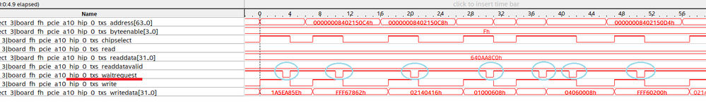

1) For good eth-receiving direction, in which "mSGDMA (mm_Write) moves data from TSE MAC into PCIe HIP TXS ", "PCIe txs_waitrequest" signal can be deasserted to activate the mSGDMA (mm_Write) into Host memory very quickly, and the interval is ~10 clock cycles or so. (see "mSGDMA_writedata.png" )

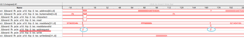

2) For failed eth-transmit direction, in which "mSGDMA (mm_Read) moves data from PCIe HIP TXS " into TSE-MAC, "PCIe txs_waitrequest" signal was very slower to be deasserted to activate the mSGDMA (mm_READ) operation from Host memory into TSE MAC , that interval is ~160 clock cycles which is much bigger. (see "mSGDMA_readdata.png" )
Above 2 pictures show the "txs_waitrequest" behaviour is very different, Has anyone seen this before or have any clue what could be causing this?
