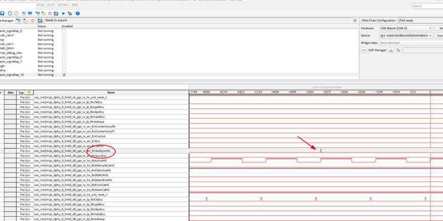

We are trying to connect a camera to the DPHY and CSI-2 on agilex 5 but we keep getting SoTSync errors and no signal output on the AXI stream from the CSI-2 IP. What would you suggest to fix this issue ?

    We have the same issue ,

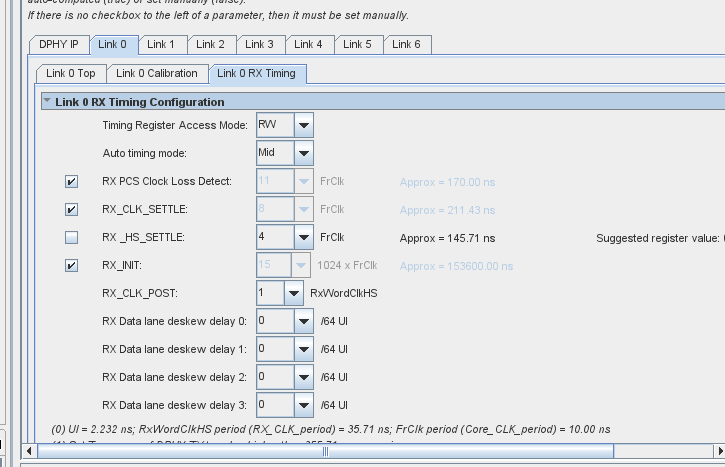

    Continuously detected ErrSotSyncHs, and try to modify rx mipi timing config ,
    But it didn't have any effect.

    3. About the sotsync errors , can you show me more so that i can more visualize the error that you are seeing ? for example error log, signaltap or any error message printscreen.
