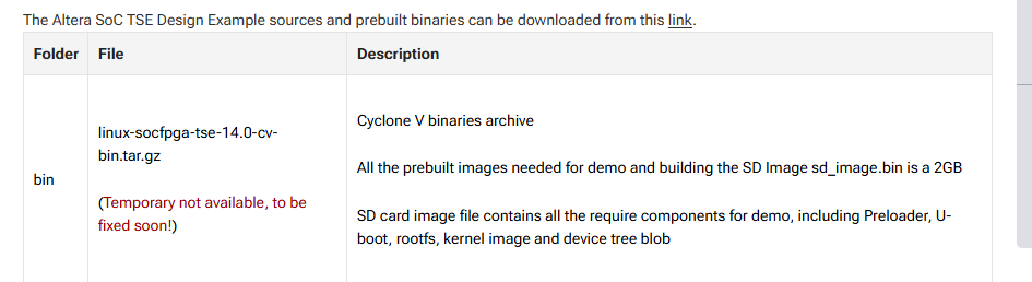

- Cloudscraper
I thought I had been clear already, but apparently not.
The WEBSITE is indeed available, but the download link for the archive with the project is not available, as explicitly mentioned in the website itself
