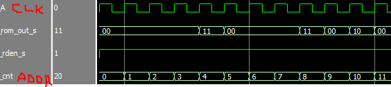

When I simulate the design (where I read the content) it looks like the address corespond to the bytes in the memory - not to the 2-bit words. So the memory expose only two least significant bites of the bytes in the memory - see image below.
Memory initialization content:
Output of the memory - simulation:
I assumed that next 2 BITS wil be exposed to the output when I incement the address.
Is it correct behaviour of the memory with this configuration?
