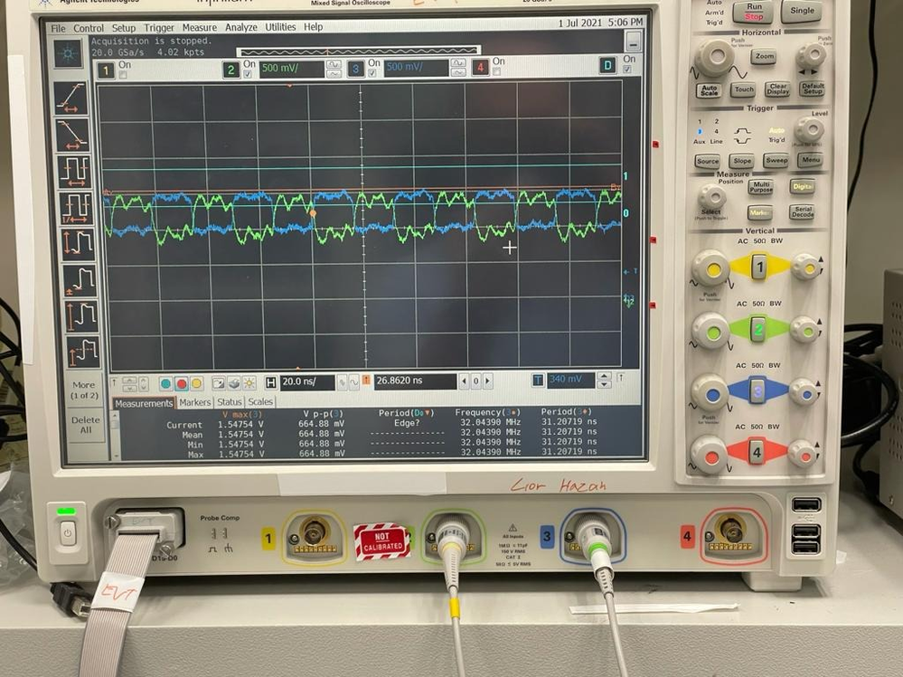

I have task to transmit data from 1 board to another
Each board has FPGA stratix 10M
To do it - I use LVDS SERDES IP in FPGA (TX) and other LVDS SERDES IP in FPGA (RX)
All the pins define as LVDS (including clocks & data)
My problem is : Sometimes pll lock flag doesn't lock
I don't know what is root casue for that - but I sample the clocks by scope
You can find it in the attached pic :
Do I need change the IO standard ?
Do I need change the internal termination ?
BR,
Yishay

Hi
Do you know what could be the reason for the unstabilty lock ?
Each reset / PWR on/off or FPGA loading get another lock flag value from the SERDES IP port
Yishay

You may want to look into the terminations applied to each of the LVDS pins. Also, you can check on the RREF pins. For more details, please refer the Stratix 10 Pin connection guidelines. https://www.intel.com/content/www/us/en/programmable/documentation/lod1484643014646.html#wsh1484644837897
