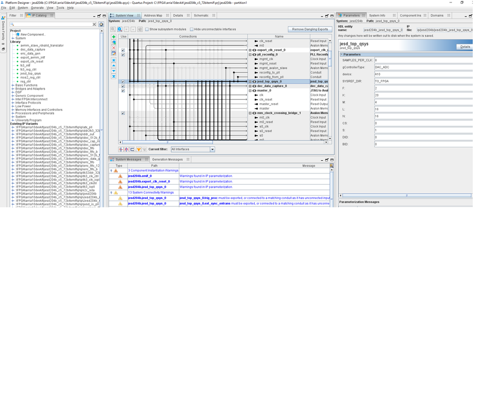

While I am reading the "JESD204B Intel® FPGA IP User Guide" 21.3.
it claims in the core features "• Single or multiple lanes (up to 8 lanes per link)"
I don't quite understand this 8 lanes per link limit.
I have a design from Texas Instrument, the parameters of the IP core use 16 lanes in 1 link(I guess).
can anyone familiar with JESD204B core, give me some suggestion. how to understand the 8 lane per link limit.
thank you,
David
