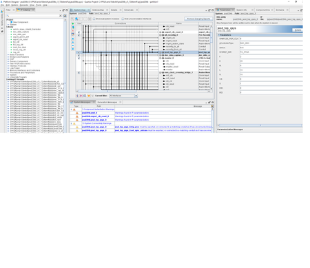

Dear Support and Expert, While I am reading the "JESD204B Intel® FPGA IP User Guide" 21.3. it claims in the core features "• Single or multiple lanes (up to 8 lanes per link)" I don't quit...

    You may refer to chapter 2.3, and 2.5 of the JESD204B Intel FPGA IP User Guide for more details.
    I believe you are talking is the Lanes per converter device.
    In your case, your project require 16 lanes, hence, you will need 2 converters.
    Thank you.
