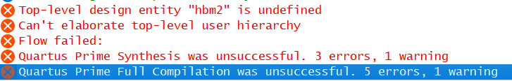

We tried generating an example design of the IP(hbm) and added it to our project( i just added the .IP files to the design), but we get an error saying
what should be done for a successful compile and simulation from this point on

Way more details needed here. Which device? Which version of Quartus? What flow have you followed?
If you're generating an example design for the HBM, it's a standalone Quartus project. Did you test that before trying to integrate it into your design? And how are you doing this integration? Just adding .ip files to the project is not enough.

How do I integrate this IP into a project and how do I test it (an example design)? Is there any user manual available for that? These are some of the details of the project
set_global_assignment -name LAST_QUARTUS_VERSION "20.1.0 Pro Edition"
set_global_assignment -name PROJECT_OUTPUT_DIRECTORY output_files
set_global_assignment -name MIN_CORE_JUNCTION_TEMP 0
set_global_assignment -name MAX_CORE_JUNCTION_TEMP 100
set_global_assignment -name DEVICE 1SM21BHN1F53E1VG
set_global_assignment -name FAMILY "Stratix 10"
set_global_assignment -name ERROR_CHECK_FREQUENCY_DIVISOR 256
set_global_assignment -name EDA_SIMULATION_TOOL "ModelSim-Altera (Verilog)"
set_global_assignment -name EDA_OUTPUT_DATA_FORMAT "VERILOG HDL" -section_id eda_simulation
