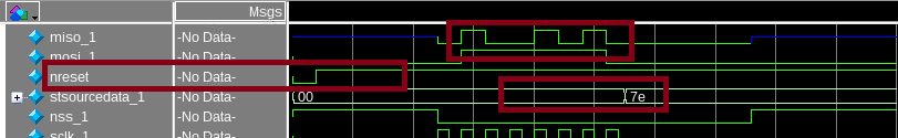

Now, I use the Avalon-ST Serial Peripheral Interface (SPI) Intel FPGA IP(19.15) core in order to stimulate the SPI salve behavior.

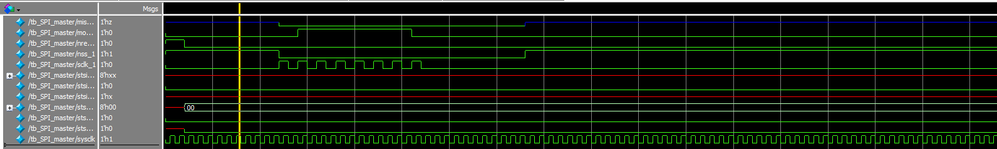

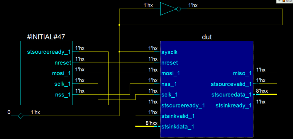

However, when I want to use the Questa to stimulate SPIsalve. I can not stimulate success.
I think my testbench is inistatation successful. But my wavefrom did not work.

Your design is in reset.
Since the reset signal is of type "active low", try changing the reset polarity in your TestBench and your waveform will work.
