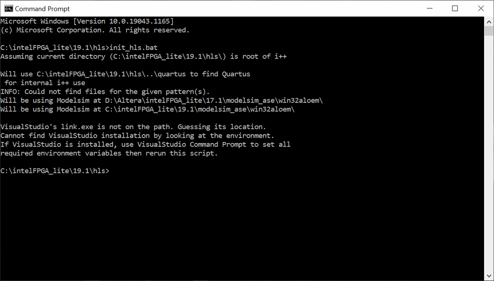

Hi, I am trying to get started with the hls compiler,
when I run the init_hls.bat I get the output below:-
I understand it can't find my Visual Studio, but should the i++ compiler stil work?
I can't seem to get any examples to compile,
regards
Konrad

    Also can you please run the init_hls.bat and provide a screenshot of the output so that we can better understand the error.

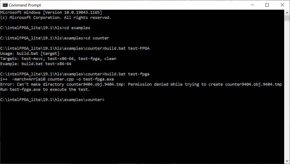

        I get the following when trying an example, this is my home computer where I have full administor rights, Windows 10

  • Hi @Konrad,
    Apologies for the confusion here, the screenshot cmd was not running with adminstrator permission.
    So are you saying that you are still getting the permission error after you have launch the cmd with admin rights?
    Where is the HLS project location?
    Can you also try to move the project to a more general directory (e.g. Documents) for compilation?
    Hope that clarify.

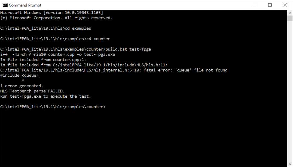

    • Konrad's avatar
      Konrad
      The installation had left all folders as read-only and I reset them to full access read/write.
      I now have a compile error:-
      Konrad

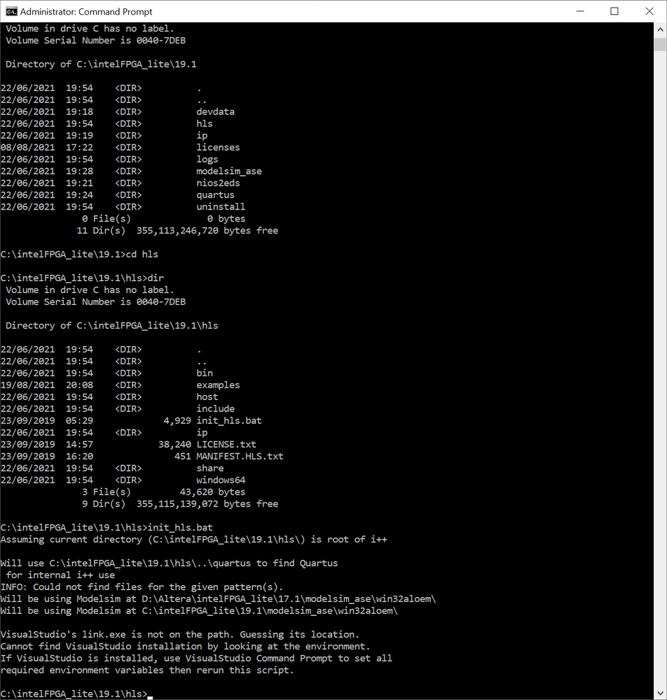

  • Hi @Konrad,
    Suspecting that the hls component are not able to detect the Visual studio installed.
    Can you please try to running the init_hls.bat file in admin privileges command prompt and check/share on the output.
    If the visual studio are not detected, would advise to reinstall in C drive if possible.
    Please do let us know if that helps to clarify.
    Best Wishes
    BB

      • BoonBengT_Altera's avatar
        BoonBengT_Altera
        Icon for Moderator rankModerator
        Hi @Konrad,
        Based on the output from init_hls.bat, VS are not found.
        And I notice that you are using HLS 19.1, for that it requires VS 2010. (as noted here)
        Can you please try installing the VS 2010 pro and rerun the command, and I believe it should work.
        Hope that clarify.
        Best Wishes
        BB
