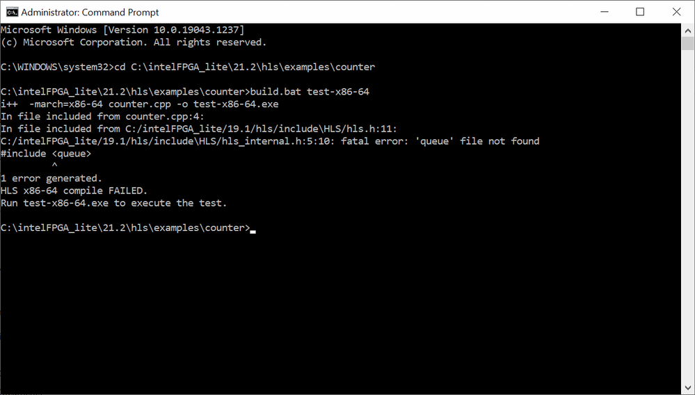

I have VS 2010 Pro available at work but not at home. I have installed HLS 21.2 PRO.
Does this need a license or is it OK with Quartus Lite?
From what I have read it seems the HLS Pro is OK without Quartus Pro.
Anyway, when I run the tools they are still pointing to the HLS 19.1 compiler. The init_ .bat ran OK.

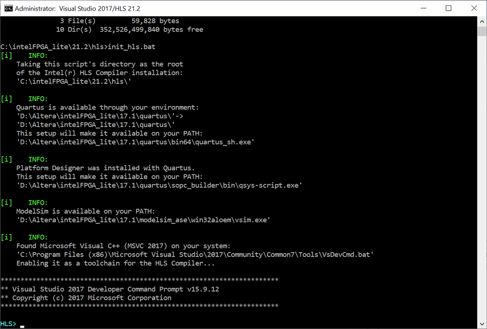

- Konrad4 years ago
Screen shot of the init_hls.bat
ps. I also have quartus 19.1 installed on my C:\ drive in the standard location...I opened and closed it prior to running to ensure it was the last version run, but the init_hls.bat seems to still pick up on the older version,
Konrad
