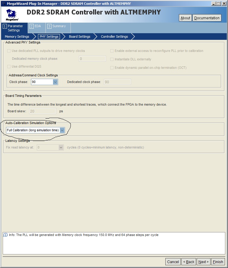

Disable Calibration in Megawizard window

thank you !
but I can't understand, - Altera_Forum
