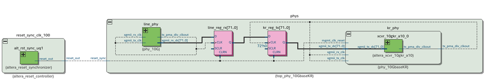

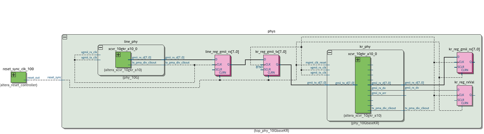

Hello dlim, thank you for the quick response. I think I understood your point. Please help verify my implementation:
I am attaching two pictures towards the end of this reply --- showing the data paths --- XGMII (for 10G) and GMII (for 1G).
Logically, my Ethernet PHYs look something like this: SFP+ --> 1G/10G Phy --> KR PHY --> Backplane connector
- Line PHY == SFP+ to A10 1G/10G PHY
- KR PHY == A10 KR PHY to Backplane connector
Question: Do you see any issues in the data path - especially for XGMII ... do I need to re-wire for SDR XGMII? (like the table shown in page 137 of the Transceiver User Guide)?

Hi JShel4,
It's fine to connect xgmii_rx_dc to xgmii_tx_dc. It should be able to recognize as both are Intel FPGA IP. The XCVR PHY user guide doc explanation is meant for connection to 3rd party IP that use xgmii_sdr_data/ctrl interface.
Can you traced the timing failure path is really constrained within KR PHY IP only. Then this is expected known issue that can be ignored as mentioned in XCVR PHY user guide doc. Refer to attached pic.
However, my recommendation is to always use latest Quartus version (for instance v18.1) to compile your design so that it contains all the latest issue bug fix.
dlim
