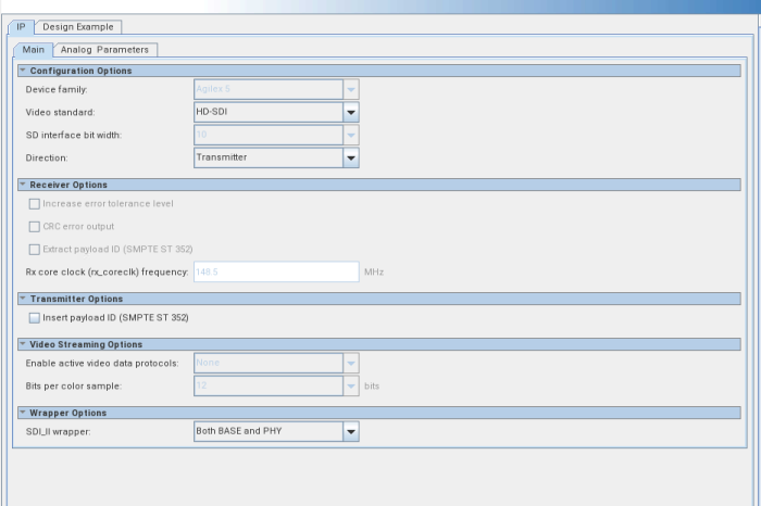

Hi Wincent_Altera ,
Sorry, but i'm a bit confused by your answer. There is no 25-bit HD-SDI setting. The bit width is set by the Video Standard (except for SD-SDI which can be selectable 10 or 20-bits, but not sure its even supported for Agelix 5). So if you're saying 25-bits is being selected, how do I force it back to 20?
thanks, -rob

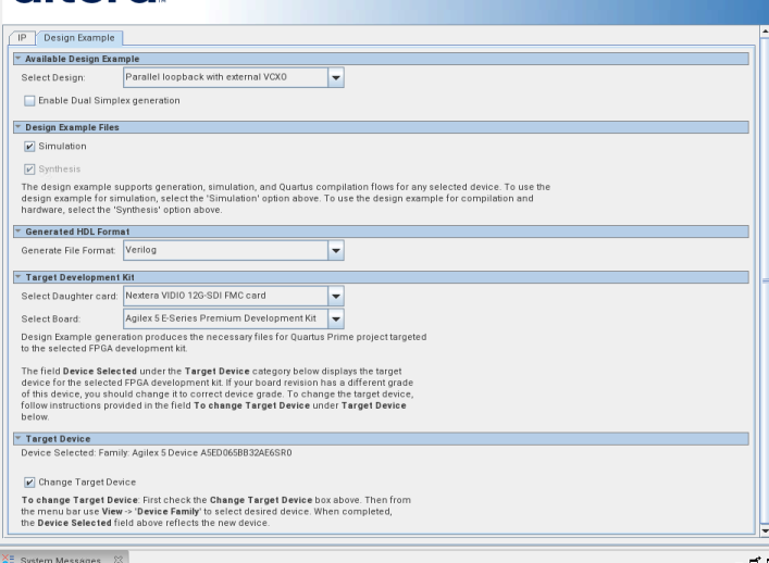

- Wincent_Altera8 months ago
Hi aucamera1 ,
Thanks for your clarification, I might need to replicate and investigate this issue on my place.
It may take sometime, get back to you later.
One things to confirm, you are checking this via example design generated from the Quartus IP catalog right ?
Hi aucamera1 ,
I cannot attach the design file in here, let me work it out.
At the meantime, you may try to program the .sof and capture the .stp see.
below is my parameter setting, adding some measurement logic to capture the frequency.Regards,
