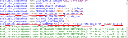

Hi Arley,
Can you try to
set_instance_assignment -name VIRTUAL_PIN ON -to *pipe_sim_only*
set_instance_assignment -name IO_STANDARD "3.0-V LVTTL" -to pcie_rstn_pin_perst
ensure pcie_rstn_pin_perst is whatever this port is called in your top level.

- ArleySalvador
Hi Wincent,
I just confirmed that both constraints are present in my QSF.
Additionally, the pcie_rstn_pin_perst pin is connected to the top level interface.
I have attached the QAR file here.
Arley

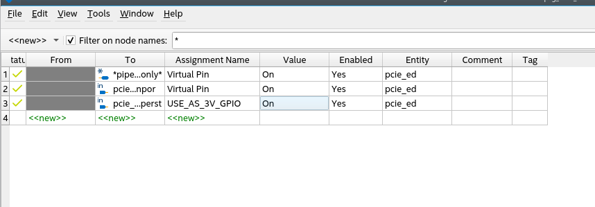

- Wincent_Altera
Thank for your response, I assume the same error still happen right ? the problem seen more clear to me.
In that case, There is a method on my mind that worth to try for us to narrow down more further
- Can you please try set_instance_assignment -name USE_AS_3V_GPIO ON -to <your pin name>
- this was specified in S10 IO UG: https://www.intel.com/content/www/us/en/docs/programmable/683518/21-2/guideline-i-o-standards-limitation-for-and.html
- Also same problem been reported in KDB before https://www.intel.com/content/www/us/en/support/programmable/articles/000091170.html
Let me know if this helpful. Looking forward to hear back from you.

- ArleySalvador
Hi Wincent,
Sorry for my late response.
I have tried your suggestion
And I still didn't get a the perst pin placed by the tool.
Arley
- Wincent_Altera
Hi Arley,
Is okay, I still remain this open for three days after my last message in case you reach back.
I see there is a three settings for the pin, if follow the KDB provided.
Can you please just remove other settings that you make before but remain the "set_instance_assignment -name USE_AS_3V_GPIO ON -to pcie_rstn_pin_perst" ONLY as per mention in the KDB ?
To avoid any miss match, I would suggest you to generate a brand new design for that.Hoping to hear back from you.

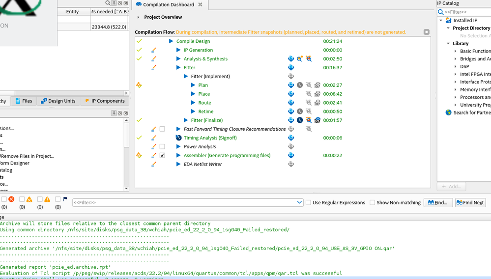

- Wincent_Altera
Hi Arley,
Apologize for late reply, I use the .qar file provided by you pcie_ed_22_2_0_94_1sg040_Failed.qarInitially it fail, I got the exact error as you, but after implementing the solution stated in the KDB.
I was able to run 100 % full compilation without any error
Could you please try it again ?
Regards,Wincent_Intel
