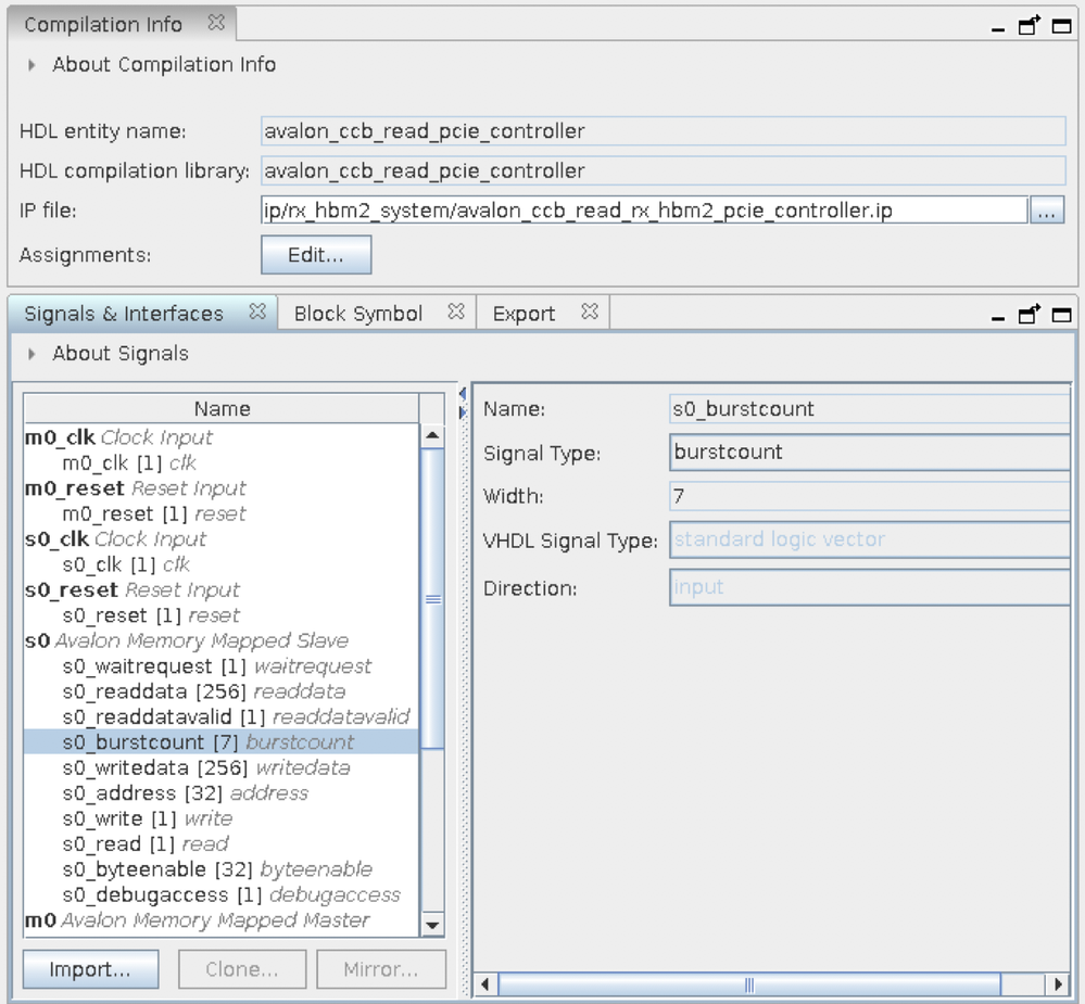

In QSYS the 7 bit is present but the generated top level has 8 bit:

    i've recognised the .ip file is still the same after editing in QSYS (inside of my .qsys file).
    I have fixed the bit width in the .ip file and now it's working!
    Furthermore now the entity, Qsys and the instantiation has the bit width of 7 for the burst width.

    The value of the generic doesn't necessarily have to match the actual hardware that's implemented. Are you saying that you specified 8 in the IP Parameter Editor, but you're only getting 7 bits for the burst count bus width?
