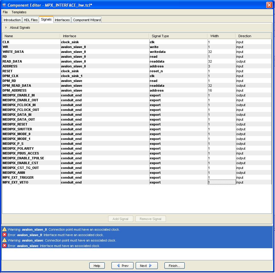

Hi, if wanna use my own periphery, so in the SOPC is this
<html>Warning: <b>.avalon_slave_0</b>: Connection point must have an associated clock.
<html>Error: <b>.avalon_slave_0</b>: Interface must have an associated clock.
<html>Warning: <b>.avalon_slave</b>: Connection point must have an associated clock.
<html>Error: <b>.avalon_slave</b>: Interface must have an associated clock.
But i have clock for each slave port(in picture).
Any suggestions? Vaclav
1 Reply
  • Altera_Forum's avatar
    Altera_Forum
    Clock for slave interfaces should be selected on "interfaces" tab.
