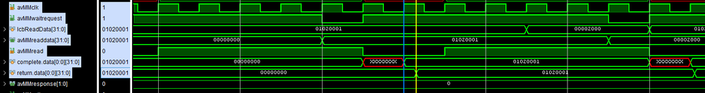

the data seem delay by 1 register transaction eg.
READ addr=0 data=0
READ addr=4 data=1020001 <- this data should be at addr=0, but get_response_data(0) pop on the next addr
return.data (get_response_data) has 3 ns delay from rising clock edge or from complete.data change

      i just used completed_read_response.data instead, return_response.data has 3ns, delay, if i pop it, it only get the data from previous push which is 0.  so delay dont work

      so i found the issue.
      data = u_avalon_MM_gen.mm_master_bfm_0.completed_read_response.data[0];
      data2 = u_avalon_MM_gen.mm_master_bfm_0.return_response.data[0];
      $display("Data=%0h Data2=%0h", data, data2);
      data will show the correct  1020001 , but return_response.data is 0  seem like there are some delay between these two.  i'm using quartus 23.4 to generate IP for avalon MM BFM.
