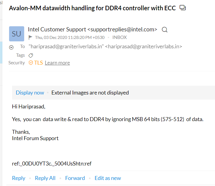

5 years agoHi,
I got the reply through mail as below.
Hi Hariprasad,
Yes, you can data write & read to DDR4 by ignoring MSB 64 bits (575-512) of data.
