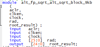

ALTFP_SQRT IP Core data width is not 32bits
I want to use ALTFP_SQRT IP Core,but when i finish configuration,the IP core interface has only 26bits input ,and 25bits output,they are not 32bits, my fpga device is cyclone IV family, i was use quartus 11\13\17\18, but all of their file has the same question, and the question also appears to ALTFP_ADD_SUB IP CORE, I'm not good at English, pardon me, but i really want to fix this problem.
- CheepinC_altera
As I understand it, you have some inquiries related to the altfp_sqrt input port witdh. For your information, I have tested generating the HDL using CV devices in Q17.0Std (because I do not have CIV device installed). As I look into the .v file, it seems like the module in your screenshot is a low level block instead of the top level altfp_sqrt module. You may scroll down to the bottom of the file and your should see something like the following which matches the IP GUI and with 32 bit data width:

Please let me know if there is any concern. Thank you.
- HAnge1
so glad to see this answer, and thanks for your warm heart, Merry Christmas,have a good day. ^-^
