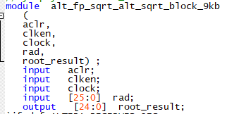

ALTFP_SQRT IP Core data width is not 32bits
As I understand it, you have some inquiries related to the altfp_sqrt input port witdh. For your information, I have tested generating the HDL using CV devices in Q17.0Std (because I do not have CIV device installed). As I look into the .v file, it seems like the module in your screenshot is a low level block instead of the top level altfp_sqrt module. You may scroll down to the bottom of the file and your should see something like the following which matches the IP GUI and with 32 bit data width:

Please let me know if there is any concern. Thank you.
so glad to see this answer, and thanks for your warm heart, Merry Christmas,have a good day. ^-^
