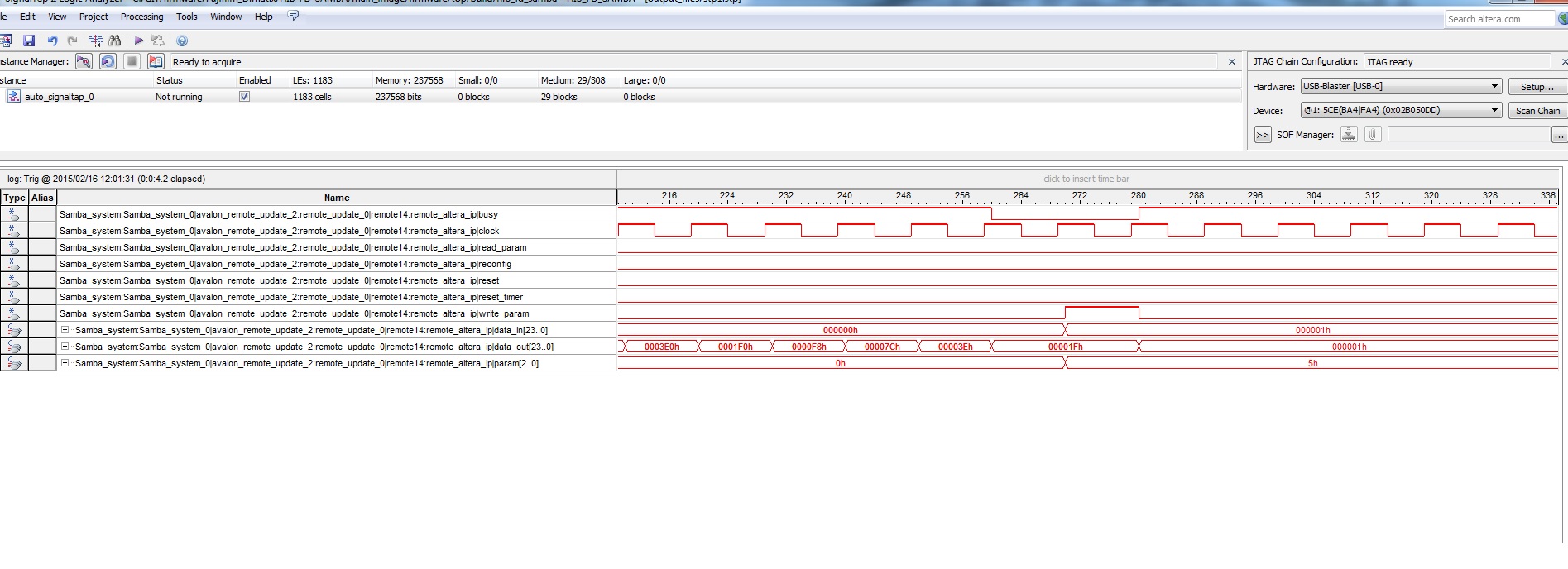

    I update a screen after reset and then i read the status register.
