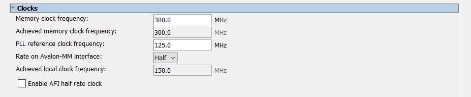

altera_mem_if_ddr3_emif used to have a parameter box 'enable afi half rate clock' in Quartus 18
Somewhere between V18 and V23 it has disappeared and I cant get afi_half_clk to work any more.

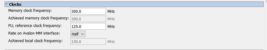

If opening Platform designer with no Project selected , I see the 'half-rate' tick box in DDR3 SDRAM Controller with UniPHY Intel FPGA IP, regardless of Quartus version.
If the project is for a MAX10, the tick box disappears and I have no afi_half_clk.
I can find no explanation for this. - NGord

Hi NGord,
For Max 10 FPGA device, the DDR3 EMIF IP doesn't support afi half rate clk.
I think the Cyclone V device is used by default if no project is opened.
Therefore, the DDR3 EMIF IP is targeting to Cyclone V and you may see the afi half rate clock option.
