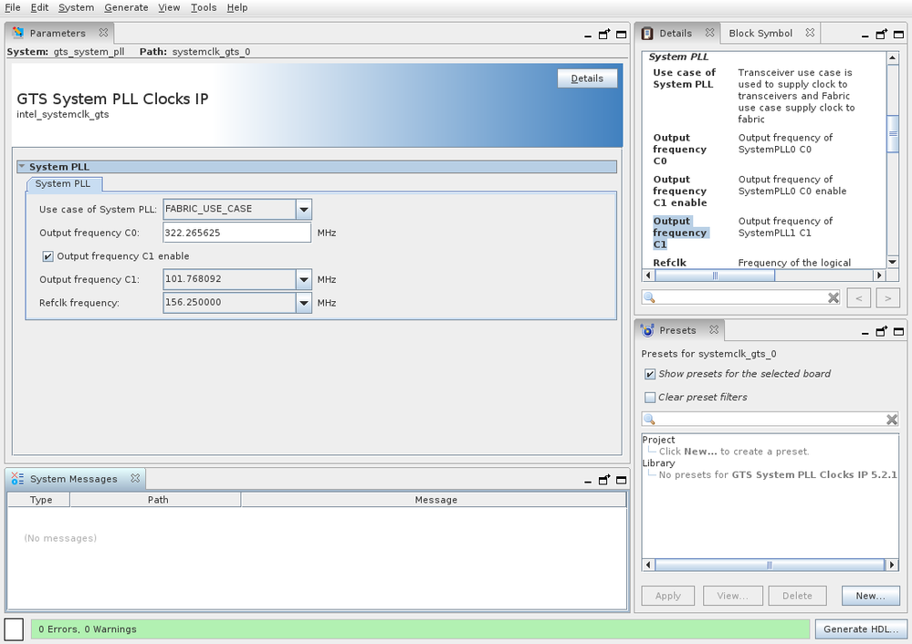

Agilex5: How to use a GTS refclk to clock the FPGA fabric?
I tried to use the GTS System PLL configured with FABRIC_USE_CASE and ref clock frequency to 156.25MHz, C1 enable and selected 101.768092 MHz from the C1 output frequency menu but this results in the following error:

    I did a test with c0 output clock. How do you connect c0 in your test?
    I see that c0=322.265625, c1=101.768092 is accepted. But I neither get the reported error when using c1 clock in FPGA fabric.

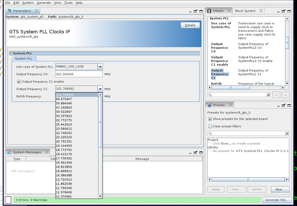

  • zener's avatar
    zener
    Thank you for the feedback. I'm not able to manually enter any frequency in the field, only select from the dialog box as shown below:

    FABRIC_USE_CASE compiles for me with 100 or 101.875 MHz output frequency. Chosen 101.768092 MHz can't be implemented with 156.25 MHz reference frequency.
