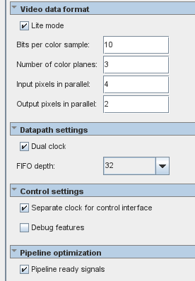

  I am using VVP Pixels In Parallel converter Lite Mode, convert from parallel pixels from 4 to 2.
Configurations see below.

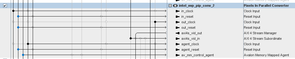

All the connections are fine and no error messages on Platform Designer.
But failed to pass synthesis for errors like, clock connection..
  How can I debug this issue?

  • Well, I solve it after inspecting the clock connection..
    For unknown reason, it was removed silently by Quartus.
