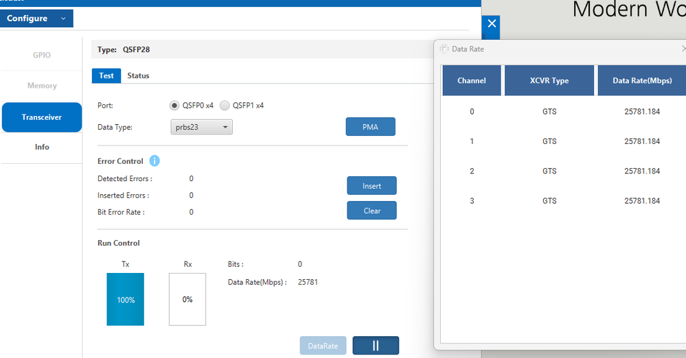

It will not work that way. The test with external loopback assumes that you have attached a loopback plug to either QSFP0 or QSFP1, looping back TX to RX for each lane internally within the QSFP chosen. You have looped back QSFP0 to QSFP1. You have to get a loopback plug or you can only use internal loopback with this test.

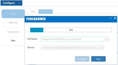

- Navigating to point 4.3.5.3 -> issue with QSFP28 design. Programmer crashes with message "failed"
- The above screenshot is for *.sof* of DDR, but similar was for the case of QSP28 as well as SFP28 as well

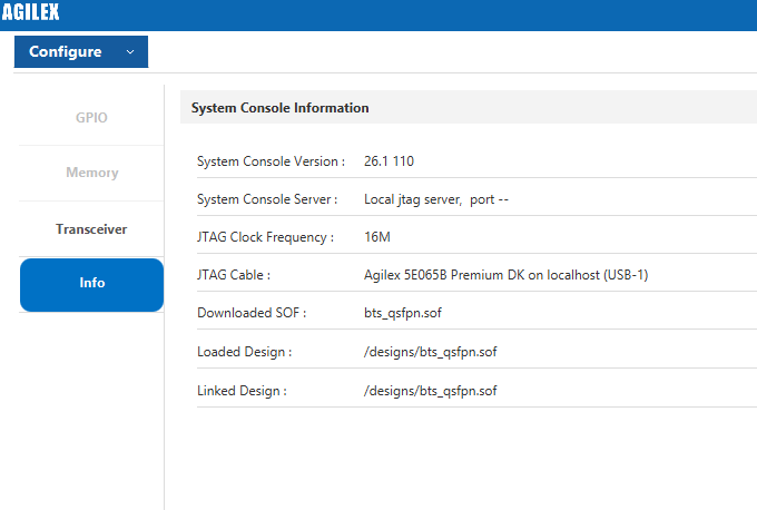

- Therefore, BTS GUI was closed. And Altera FPGA Programmer was used for loading the *bts_qsfpn.sof* file located at \\Altera_Devkit_design_package\DK-A5E065AB32AEA-26.1.0.104\examples\board_test_system\image\sm72si\PRD0\
- Once the sof loads successfully, BTS GUI is launched again. Clicking on Aglilex-5, shows the current configuration of the board.

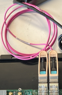

Attaching a 100G XCVR and cable for loopback - in the above case, we used the 100G Transceiver which is supposed to be compatible to Nvidia Mellanox. - Did not work. Tx at 100% and Rx at 0%.
