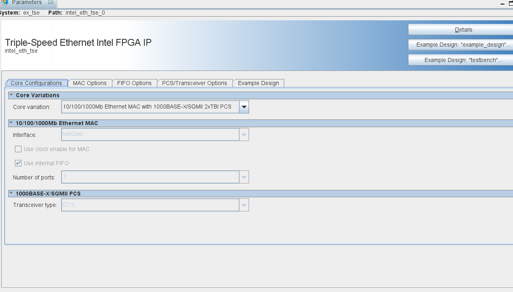

I would like to use the Triple Speed Ethernet IP Core for 16 10M/100M/1G Ethernet ports on the Agilex 5.
I am unable to set up the IP core to use the transceiver and have a PHY management bus (MDIO, MDC). How can it be set up for this?
The one option uses GTS transceivers, but then there is no MDIO option.
Thank you for your assistance.

    Quartus version 24.1 GTS Transceiver does not have an option to enable MDC/MDIO. Planned to have the option in future releases.
