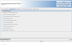

Good day, I would like to use the Triple Speed Ethernet IP Core for 16 10M/100M/1G Ethernet ports on the Agilex 5. I am unable to set up the IP core to use the transceiver and have a PHY management...

Quartus version 24.1 GTS Transceiver does not have an option to enable MDC/MDIO. Planned to have the option in future releases.

I am using Quartus version 24.2. When will this update be available?
Which clocks are required for the TSE with SGMII?
