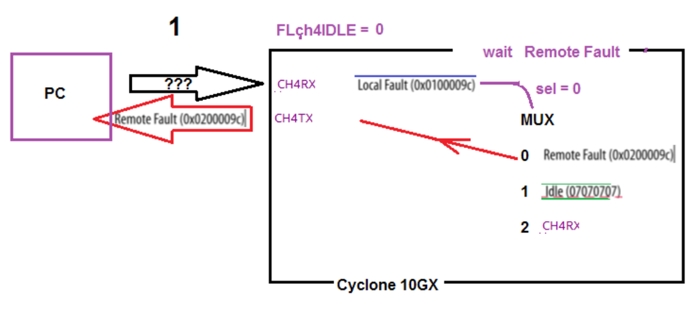

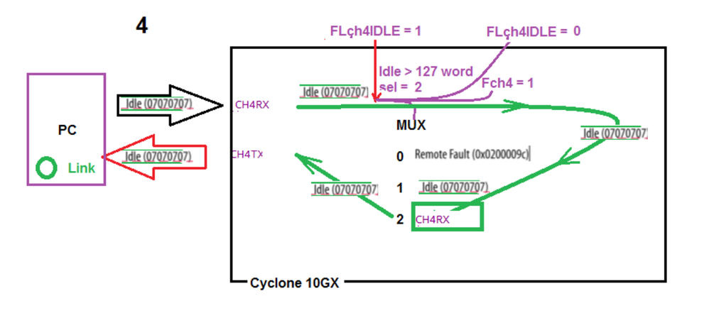

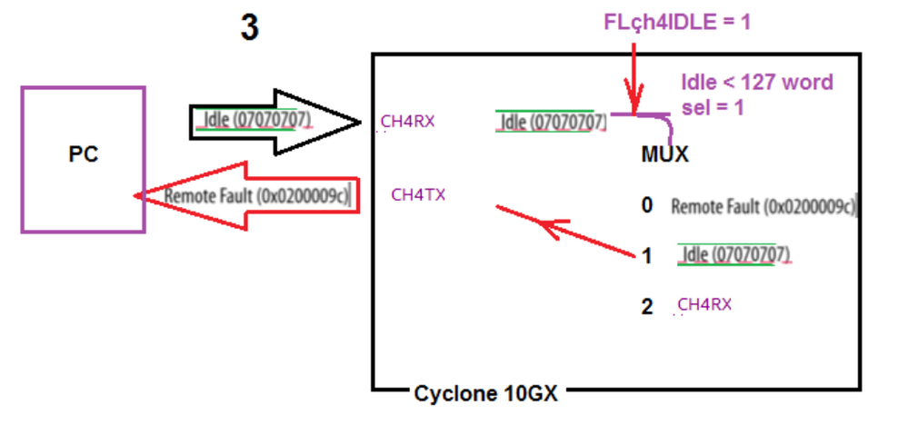

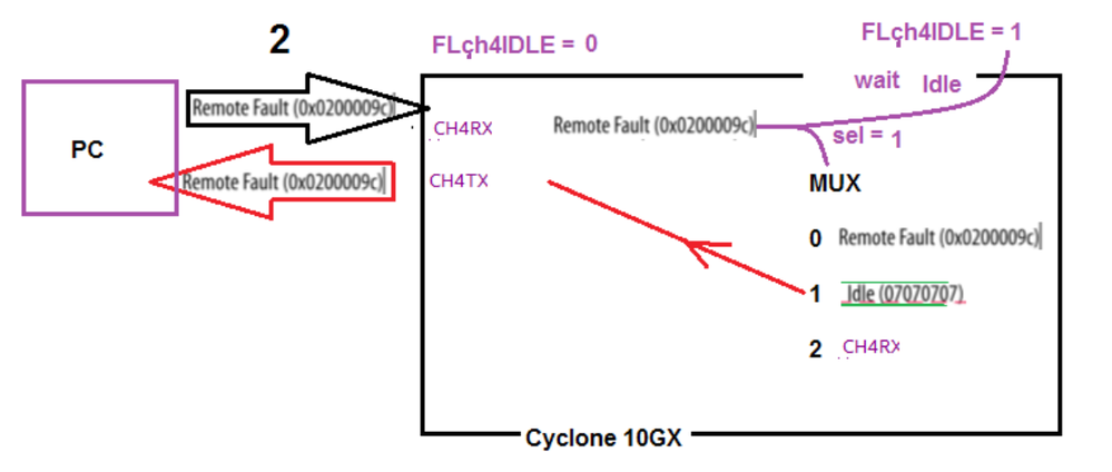

Why my Intel Cyclone10 GX can't connect to 10Gbps network adapter on PC ?
Configuration:
1) A board Intel Cyclone10 GX FPGA Development Kit
2) a network adapter on PC: 10Gbps Intel(R) Ethernet Server Adapter X520-1
3) I connect using fibre cable.
I see no LEDs on network adapter when it connects to my board on Cyclone10 GX.
But when I connects two PC with the same network adapters - LEDs works and PCs connected successfully.
When I connects two Cyclone10 GX boards connection established and works.
Below I explain my a step sequence to establish connection between Cyclone 10GX and PC.
My question is: Are the step sequence right? Or I do something wrong?
Manual:
My steps:
Thanks a lot.

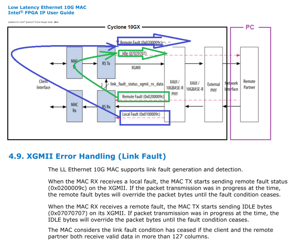

    1) Does the network adapter support 10GE protocol which is implemented in FPGA Cyclone10GX ?
    2) In my post I attached a piece of documentation which describes interaction on PHY-level FPGA Cyclone 10GX and MAC level of code which is written for FPGA Cyclone 10GX project, in case of handling Local / Remote Fault.
    3) So my question is: should I implement a procedure to handle messages Local / Remote Fault to establish a point-to-point connection between PC and FPGA Cyclone 10GX?
