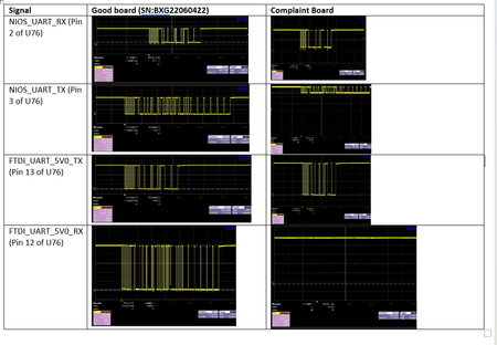

1 year agoUnexpected Voltage output on pin AB19
For this pin (AB19) we are seeing partial transition from 1.8 V to 1.3 V. The good PCBA the upper level is 1.8 volt rail. On a good PCBA, the lower level is ≤ 0.3 V. On a bad PCB, the upper l...
