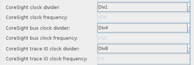

I added to the HPS Core the 16-bit width TRACE interface through Quartus, and made the Coresight Trace clock 50MHz as it’s the slowest to make sure we could see a clock. After synthesis I see the trace_s2f_clk output is actually connected from the S2F module as TPIU_TRACE_CLK to the IO pins but once we run a test through the ARM-DS I don’t see a clock coming out of the pin, but I do see data toggling through a scope
I also made sure that looking at this register all clocks were enabled

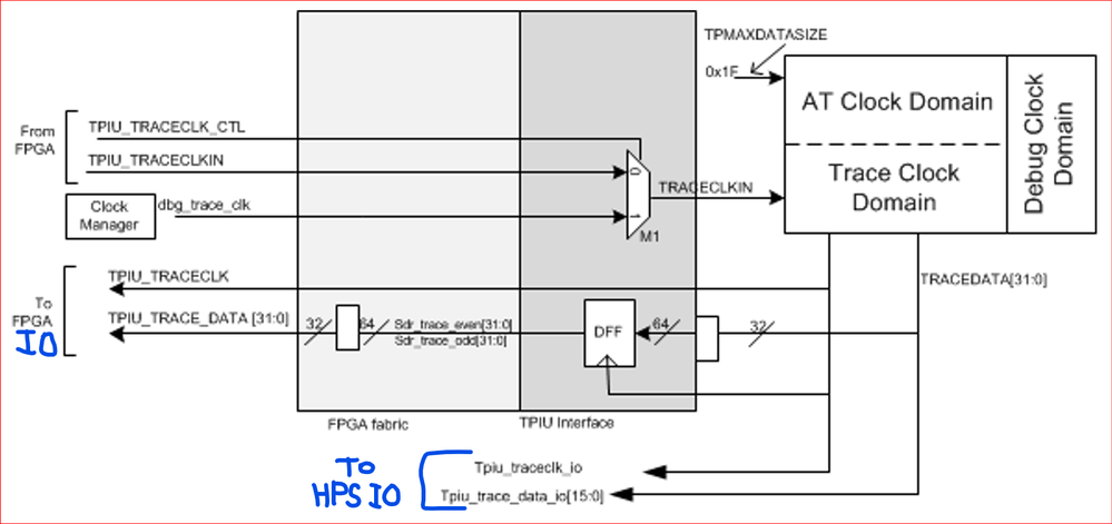

I get the information from the team where you can try to troubleshoot by checking/probing on the HPS IO instead as the path to the trace clock and data is sharing the same path to the FPGA output routing.
Aik Eu

I didn't see your latest update to test the Clock only through the HPS I/O. I am not certain we can do that as as far as I remember we dont have available I/O but I will double check on that.
From the image you sent you are suggesting I should use an FPGA Clock source to power the TRACE interface? I see I can potentially do that but on quartus 23.1 I can only do it on auto-place mode and that would change all my HPS IO which I have used the advanced feature for more personalized placement. Are you suggesting for me to try that?

From your question, remain using the clock from HPS clock manager but not using the FPGA clock source.
The only thing which engineering suggest is to check is the clock routing to the HPS IO instead of the FPGA IO as the path is more direct from the clock source.
