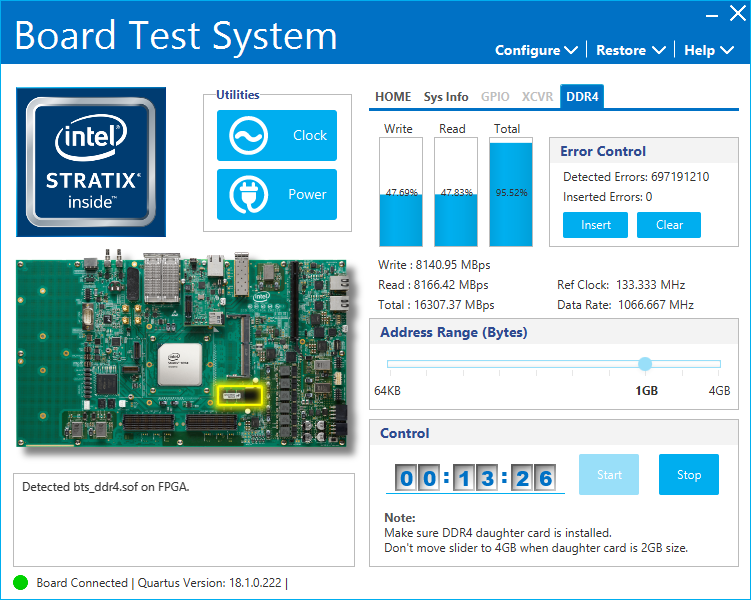

We brought new S10 SX SoC DVK. We started with initial Board testing with BTS.
we are able to program GPIO, FMCA & FMCB sof and tested the functionality. We are able to test GPIO and SERDES and its working.
We are seeing large numbers of error detected when we test the HPS DDR. Please Refer the screen shot.
May i know the reason and how can we rectify this issue?

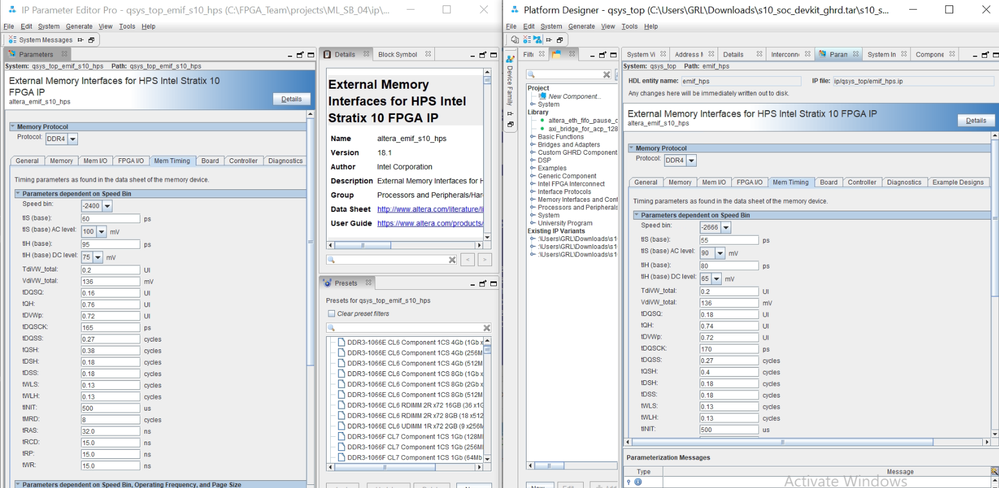

  • Reason for Failure: HPS DDR Parameters were different in example design and BTS HPS_DDR Example Design. May be deferent DDR speed grade used in old and new DVK
    If anyone face this issue with latest S10 SX DVK.
    Please change HPS DDR Parameters like below(old speed bin - 2400 and new speed bin - 2666)
    U can also download above GHRD project and reverify. above GHRD having proper HPS DDR parameter settings

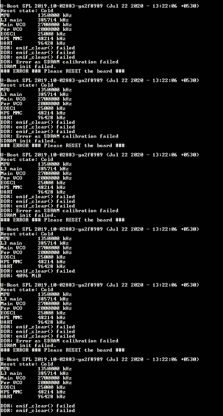

    We were purchased one S10 board and started our development activities. Unfortunately that Board gone bad. So we purchased new one and try to reassume the activity. We try to load our project in new S10 board which was booted successfully in old board, we are seeing following errors.
    DDR: emif_clear() failed.
    So We decided to test DDR Functionality with help of BTS example project that time we are seeing some error counts on Detected error.
