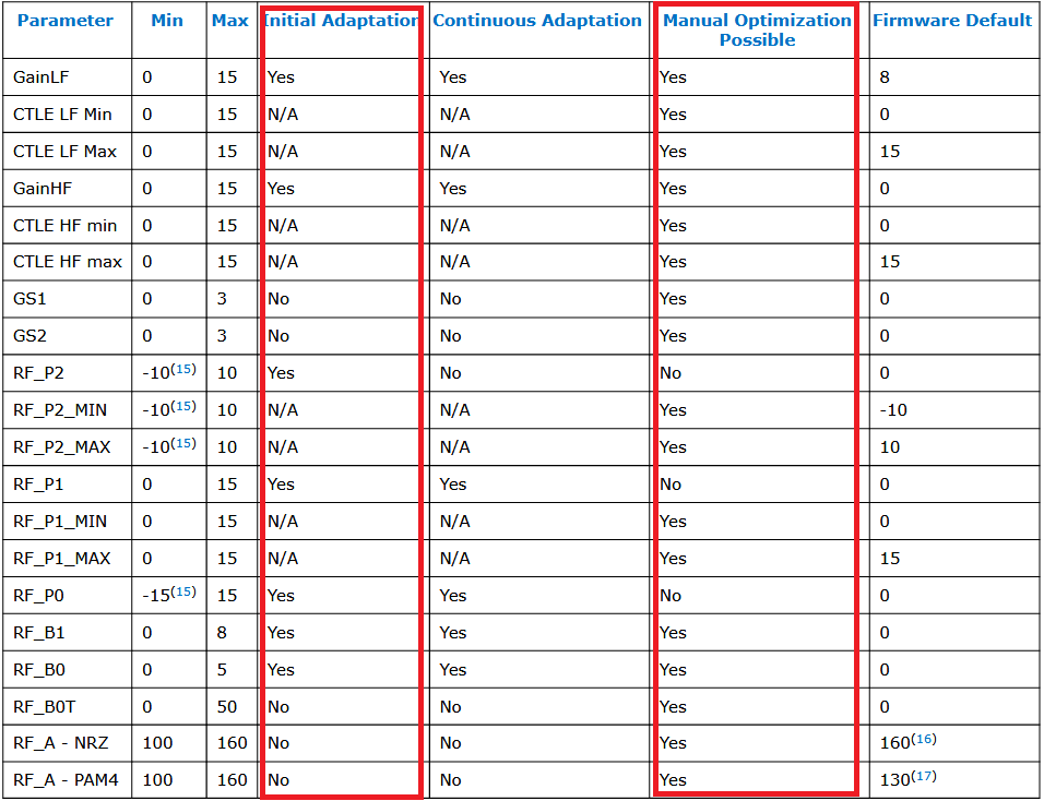

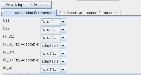

GS1,GS2,RF_B1,RF_B0,RF_A,RF_P2,RF_P1,RF_P0,RF_B0T,RF_P1_MAX,etc.
There is link fault on low data rate (2.4Gbps~4.98Gbps,9.8Gbps can link up),the signal rx_is _lockedtodata could not assert stably, So which reasons could make the link fault?
And whether does it has some help to link fault by adjusting those PMA adaption parameters manually(beacuse it could not link up after inital adaption).

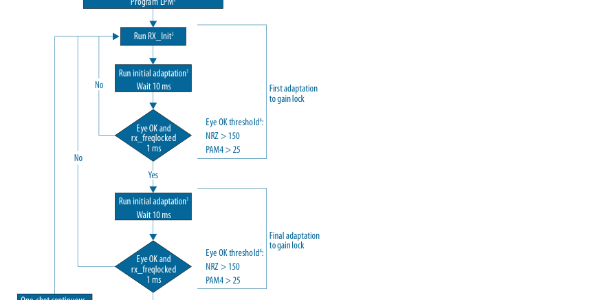

And I have another question about the inital adaption :
Why does the transceiver need at least twice the initial adaption of the chart below?
Because they need run at two different temperatures?
What is the result of running the first inital adaption only?

Please check in which condition you are running the PMA Adaptation Mode. Also, ,check the PMA Initial adaptation effort status. Please refer below link for more info.
https://www.intel.com/content/www/us/en/docs/programmable/683723/current/rx-adaptation-modes.html
Please follow the PMA Bring up flow.
https://www.intel.com/content/www/us/en/docs/programmable/683723/current/pma-bring-up-flow.html
Also, please follow the steps to perform duplex adaptation.
https://www.intel.com/content/www/us/en/docs/programmable/683723/current/duplex-adaptation-flow.html

Please try with the Initial adaption as it is mandatory for E-tile devices.

I have used the Initial adaption for PMA follow the chapter of Signal Detect Algorithm,but it can not meet the eye height(NRZ>150).
Besides, for higher data rates, It can link up after Initial adaption.
So I wan to konow that whether did it need to be optimized manually. and help to link up after manual optimization ?

We can't disclose this information as we are legally not allowed to share more information on this. Please refer to https://www.intel.com/content/www/us/en/docs/programmable/683723/current/pma-adaptation-parameters.html

I have noticed this chapter and find difference with given data rates.
And I do not know whether do i need fix those below paramters only.
Looking forward to get some ideas from you.
