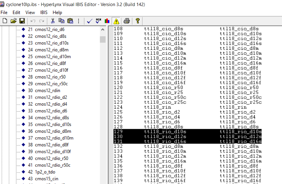

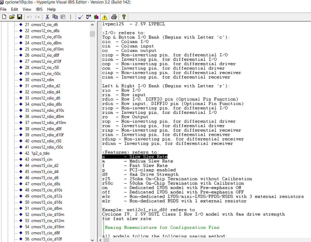

    the slow slew rate is not supported by all IO standard set to the GPIO pins. You need to use the IO standard which supports slow slew rate and set this IO standard to the GPIO pin you want to use.
    If you see the IBIS model, the IO standard with 's' at the last of their name, is slow slew rate, 'm' for medium slew rate and 'f' for fast slew rate:
    IBIS file for Cyclone 10 LP : https://cdrdv2.intel.com/v1/dl/getContent/674929
