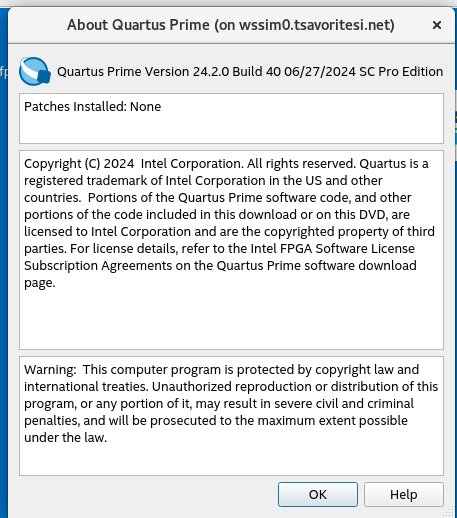

    • awaissman's avatar
      awaissman
      Hi Aik,
      I have 24.2 quartus version.
