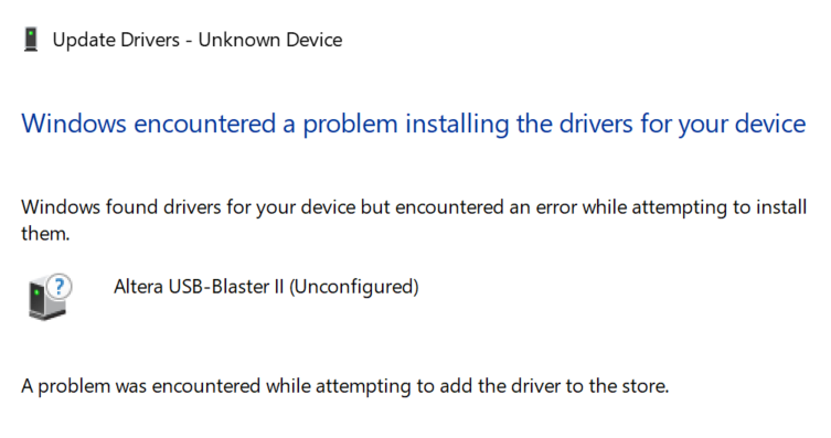

      I am having the same issue to install USB Blaster II driver for Windows 10. The workaround by disable driver signature ​enforcement is not allowed by my company IT security policy.
      I tried the fix on the link you posted. It does not work for me. The error message is:
      "A problem was encountered while attempting to add the driver to the store."
      I tried with Quartus 19.3 and 20.4. All the same error.
      Do you have newer USB Blaster II driver? Or what can I do to fix this?

        Yep... same here,
        Tried to install the original driver aswell as the FIX driver.
        Always the same error: (translated from dutch) A problem occured while attempting to add the driver to the archive.
        Also here, company policy does not allow driver signature ​enforcement.
        Urgently need to reprogram about 50 old Altera MAX7 devices.
        Any solution ???
