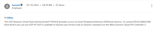

Hi HAlex,
The GSFI (Generic Serial Flash Interface) Intel® FPGA IP provides access to Serial Peripheral Interface (SPI) flash devices. To control EPCQ128ASI16N flash device you can use GSFI IP. GSFI is available in Quartus pro version only. In Quartus standard use the Altera Generic Quad SPI Controller 2.

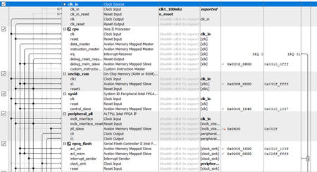

Also in Platform designer this core is greyed (when 'Show IP for all device families' is marked):
And it simply disappeared when marked 'Show IP for active device family'.
As I understand Cyclone IV is not supporting ASx4 mode.
