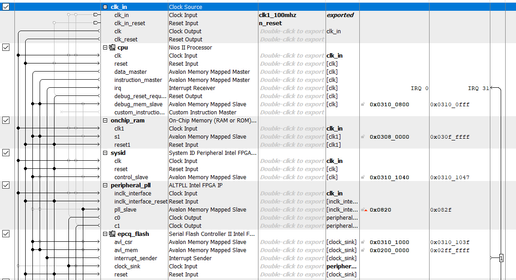

Connection designed by Platform designer at following mode:
Clock in that used by CPU (Nios II processor) is 100Mhz.
As maximum frequency to Serial Flash Controller is 50Mhz - the clock to the Flash controller connected from the PLL's output (50Mhz).
Data and instructions busses of the Serial Flash Controller connected to the Nios through 100Mhz Avalon busses directly without any crossing bridge.

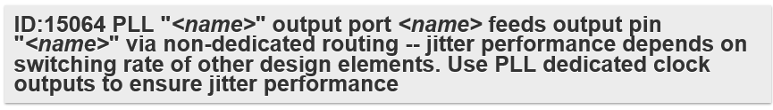

After project compilation I get warning 15064:
This warning related to ALTERA_DCLK_OBUF (DCLK of serial flash) feeds by 50Mhz from PLL.
No action related to PLL help to get rid of this warning (changing PLL's, PLL's output).

1. Is it ok to connect Serial Flash Controller II Intel FPGA IP as I did - directly to the Avalon busses without crossing bridge and to connect clock to the PLL's output? Or I can encounter a clock domain issues?

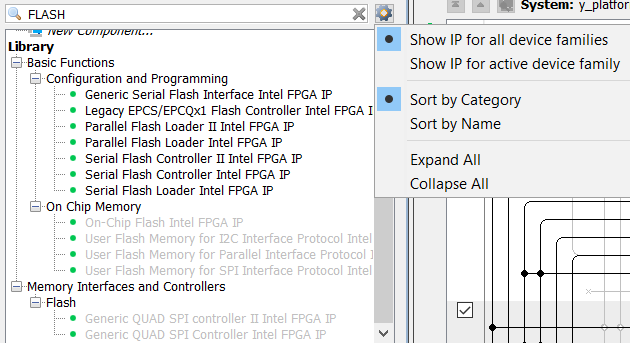

I have Quartus Prime Standard edition 21.1. also my FPGA is Cyclone IV (EP4CGX150CF23C8).
Regarding the Altera Generic Quad SPI Controller 2 look at page 262:
Even EPCQA device (EPCQ128ASI16N) is not mentioned still probably this core need a quad mode of AS.
Also in Platform designer this core is greyed (when 'Show IP for all device families' is marked):
And it simply disappeared when marked 'Show IP for active device family'.
As I understand Cyclone IV is not supporting ASx4 mode.
