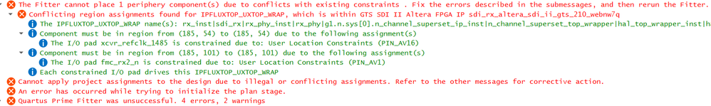

When we tried to compile we got the following errors, all of them have the same description in the drop down messages.
Initially we thought it could be due to those pins were not assigned to any logic internally, so we tried to set a couple of SDI cores as transmitter and receiver taking as reference the design examples available in the IP parameter editor.

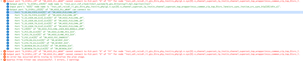

In this case, keeping only the pins connected to any internal logic we got the following errors:
These are signals inside the receiver SDI IP core, we don’t know how to fix this problem.
After facing that issue, we tried to generate the “serial loopback” SDI example, selecting as target development kit “Nextera VIDIO 12G-SDI FMC card” and board ”Agilex 5 I-Series SOC Development kit” in Quartus 24.3.1. Taking this design as base we tried to only modifying some pins to match our needs. In this case we got the following error:

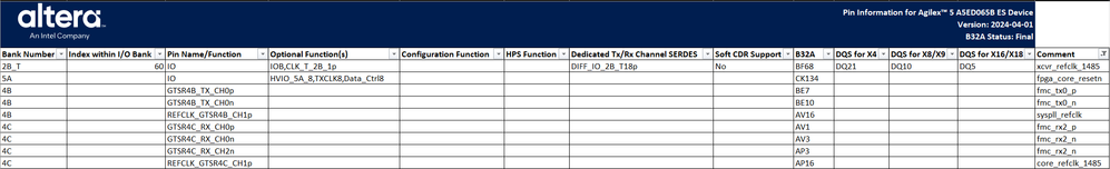

    I check the attached .qar file.
    AV16/AV21 are dedicated pins for XCVR reference clock, those can't be used directly in fabric/IOPLL.
    Please check back on your design/schematic of the Arrow board , perhaps try to assign another pin on it.

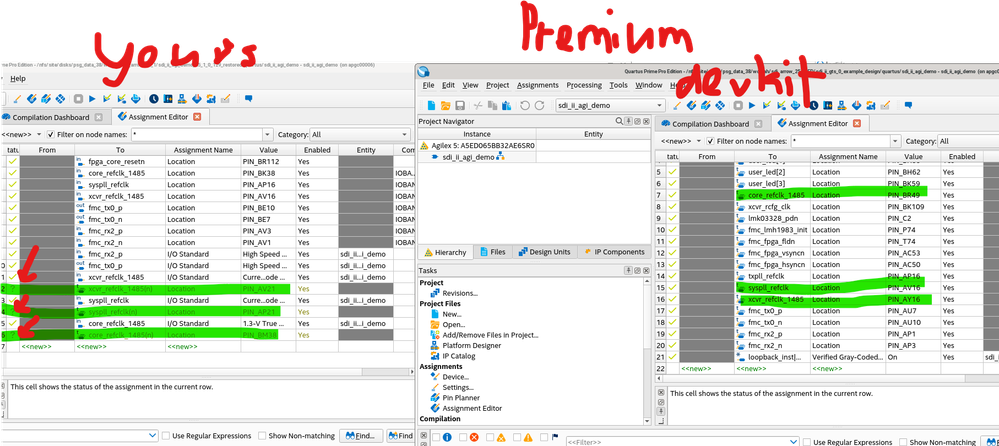

    When I compiling your design, i saw below three pin is fail to justify, comparing to design generate for Agilex 5 premium devkit

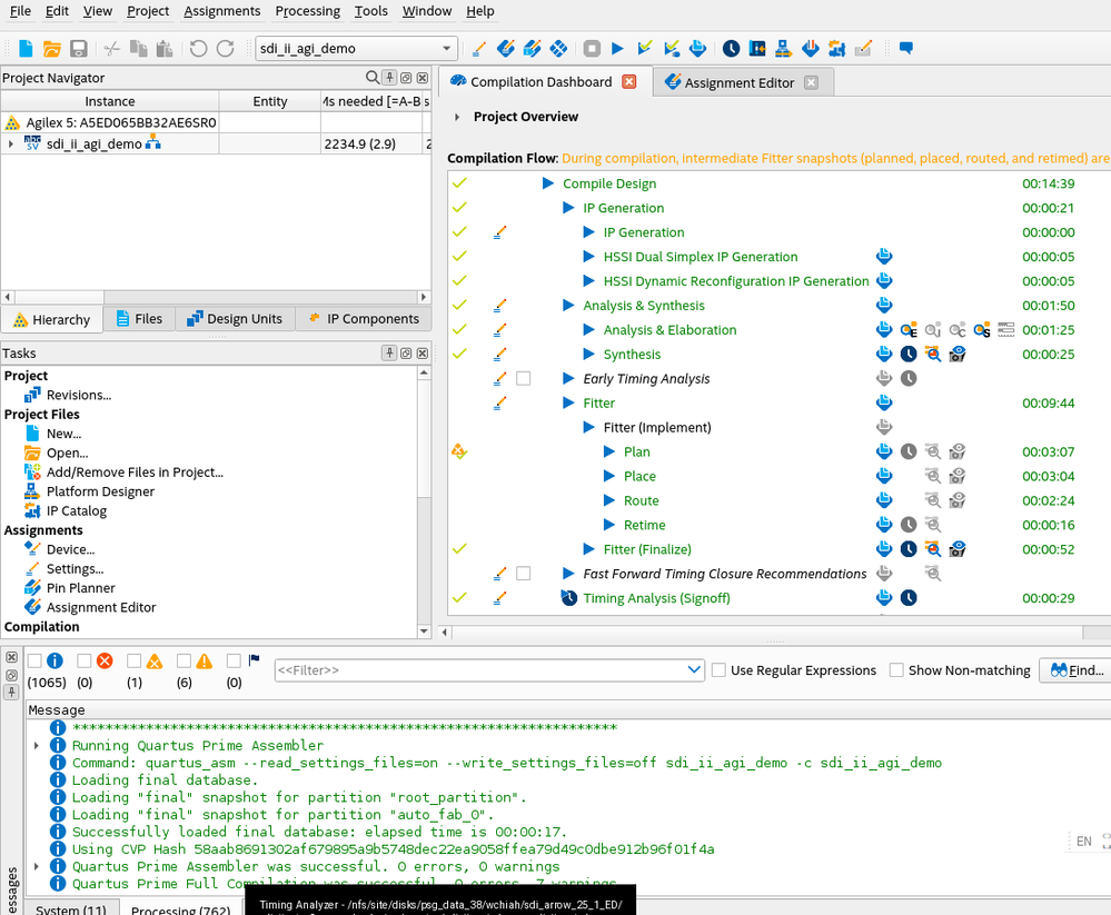

    >> Sorry I am bit confuse on this statement, from the shared .qar , i see the design is Agilex5 .. why not you try to migrate the Agilex5 design generated from the IP catalog to your existing Arrow board ?
    >> I try to compile the design via devkit, and i get the compilation pass 100 % without any error

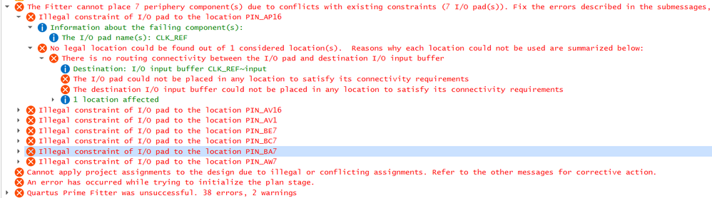

      Sorry if my previous explanation lead to confusion. As you suggested, we have been trying to modify the pinning of the generated design to be compatible with our development board.
      While we were able to compile the original generated design, when we modify the pins we are getting errors.
      Accordngly to the pinning file, the pins we intend to use should be right, aren't they?
      Trying to compile we get the following errors in Fitter stage
      We are a bit confused here, as we understand the pins are properly assigned.

        Hi ,
        I do not have any visibility to any Arrow devkit.
        From the error message, it seen like your PIN_AP16, BE7 is error. Perhaps you try to assign it into another location ?
        If this still not work, I suggest to check with Arrow directly (where you got the devkit) to check the board schematic which pin is comparable with Agilex 5 Premium devkit.
