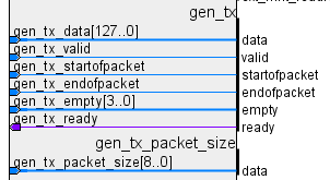

I am trying to use Rapidio II IP core to establish SRIO communication between FPGA and DSP. Here are some questions I have met:
Question 1
Are these signals used by users to tran...
- 3 years ago
Below is the answers for your questions:
- Yes, those are the Pass-Through Interface Signals
- The Avalon-ST pass-through interface is an optional interface that is generated when you select the Avalon-ST pass-through interface in the Transport and Maintenance page of the RapidIO II parameter editor.
- Yes, only 128 bits.
For more details, please refer to Rapid IO II UG.
