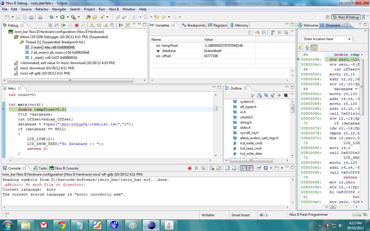

I'm not sure, I don't use the IDE myself... Can't you step in the software anyway? It looks like the options are active and the breakpoint is reached.
