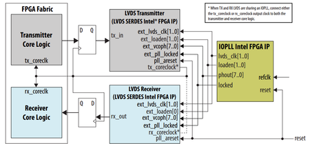

Hello - I am using Agilex7 , and I implemented the following LVDS design recommended by altera spec to place ALTLVDS and ALTLVDS RX on the same bank - (the bank used is 2F ) The design co...

Unfortunately, for Agilex 7 devices, you cannot use single ended I/O in the bank that are using 1.5V for bank VCCIO. For VCCIO_PIO=1.5V, we don't support a single ended buffer, you can only configure the I/O for True Differential Signaling (TDS).
For VCCIO_PIO=1.2V, you can mix TDS RX and single ended 1.2V LVCMOS, 1.2V SSTL, etc in the same bank. We do not support TDS TX when VCCIO_PIO is 1.2V.
