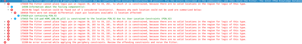

I have just started working with the Cyclone V GX Starter Kit. For what I am trying to do, I needed SDI ports, so I also purchased a HSMC SDI Daughter card as an add-on. I attached the user guides for both boards down below.
I tried using the Cyclones Starter kit tool that was provided called systembuilder.exe to generate a basic pin layout for me so I could try to make a simple SDI-SDI pass through. For some reason, that tool does not work appropriately and has pin locations up to 3 pins off from where they should be.
I managed to find a baseline pin layout provided by Intel that I am now currently using:
With this baseline pin layout I enabled the HSMC connector pins and attempted a simple SDI pass through. When attempting this I get errors for the receiver pins:
Error (177035): The input pin HSMC_GXB_RX_p[0] assigned to HSSI Pin_AD2 has no fanout.
Error (177035): The input pin HSMC_GXB_RX_p[1] assigned to HSSI Pin_AB2 has no fanout.
Error (177035): The input pin HSMC_GXB_RX_p[2] assigned to HSSI Pin_Y2 has no fanout.
Error (177035): The input pin HSMC_GXB_RX_p[3] assigned to HSSI Pin_V2 has no fanout.
In order to accommodate for this error I attempted these assignments and received these errors:
assign HSMC_GXB_TX_p[0] = HSMC_GXB_RX_p[0];
assign HSMC_GXB_TX_p[1] = HSMC_GXB_RX_p[1];
assign HSMC_GXB_TX_p[2] = HSMC_GXB_RX_p[2];
assign HSMC_GXB_TX_p[3] = HSMC_GXB_RX_p[3];
I am not sure why the constraints would affect this at all and cannot find any resources online that help with this specific issue. I will also provide my verilog file with the top-level-module. Here is my entire QSF file with all constraints:

I hope the previous response was sufficient to help you proceed. Please login to ‘https://supporttickets.intel.com/s/?language=en_US’, view details of the desire request, and post a feed/response within the next 15 days to allow me to continue to support you. After 15 days, this thread will be transitioned to community support. The community users will be able to help you on your follow-up questions.
- AqidAyman_Altera
Hi Evan,
Perhaps you can refer to our reference design involving of SDI interface.
I provide you the link below:
- https://www.intel.com/content/www/us/en/content-details/654949/an668-serial-digital-interface-reference-design-for-stratix-v-gx-and-arria-v-gx-devices.html?wapkw=cyclone%20v%20sdi&DocID=654949
- https://www.intel.com/content/www/us/en/docs/programmable/683643/18-0/an-848-implementing-triple-rate-with.html
Regadrs,
Aqid
- EvanHamiltonJAVS
Hey Aqid,
Thank you for the references, I will take a look and see what I can do. If I come across any more issues I will let you know.
Evan
- AqidAyman_Altera
Hello Evan,
From your statement, "In order to accommodate for this error I attempted these assignments and received these errors", how did you get to known to use those assignment?
Aqid
- EvanHamiltonJAVS
Hello Aqid,
These assignments are meant to assign the SDI_outputs to the SDI_inputs:
assign HSMC_GXB_TX_p[3] = HSMC_GXB_RX_p[3];These pins are the connector pins associated with the SDI Inputs/Outputs on the SDI Daughter card.
I was just attempting to make a simple SDI to SDI pass through, but I believe I need to add a transceiver component and possibly other components. I tried adding and implementing the "Transceiver Native PHY Intel Cyclone V FPGA IP", but I am not sure what my parameters should be and how to correctly install it.This is my first time pin planning an FPGA project and I really just need some help getting this project started from scratch in order for me to gain the knowledge and experience.
Evan
